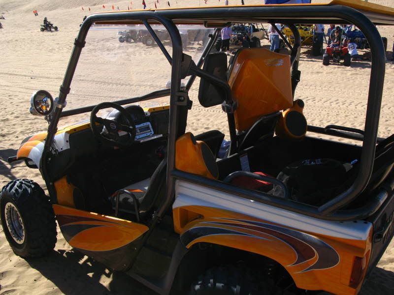

I like my canvas, because I can remove it for nice days.
I prefer aluminum, I have seen some nice ones before. I like the little flare up on the back of this Rhino
Plus taking a canvas one off and on again for transport could be a pain.
I have heard that driving at speed during transport causes the material to eventually become loose and flap around.
But everyone has their own opinion, just go with what you think looks best. :)

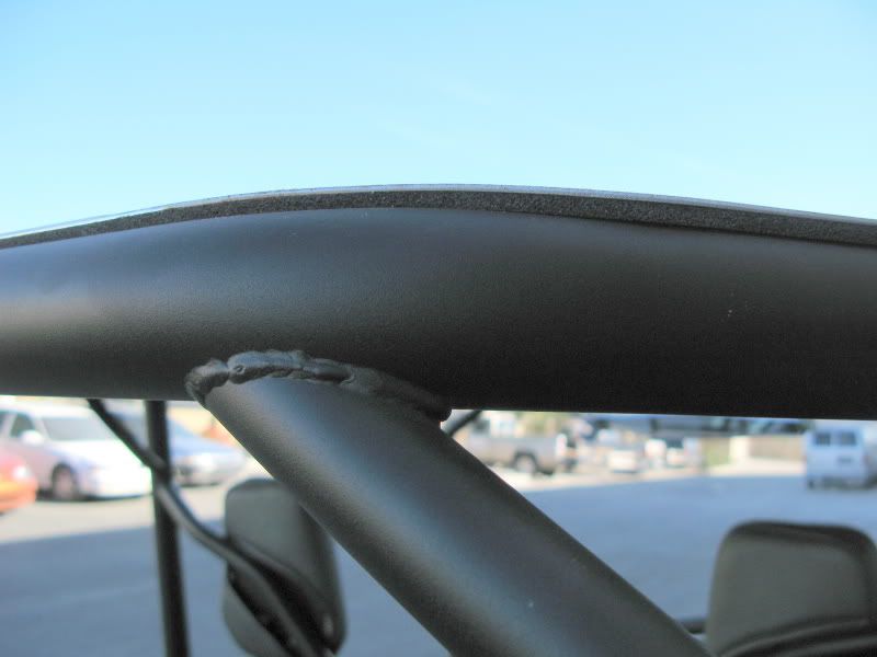

One suggestion if you use alum, insulate it with rubber washers and tape on the bar where it touches. It can sound like the inside of a tin can, especially when it goes in 4WD. I used rubber washers under the metal flat washers on both sides and foam taped the rollbar where the top touched. Now it totally quite. Just a suggestion if you go that way.
