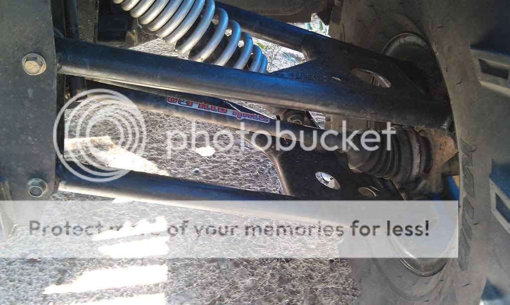

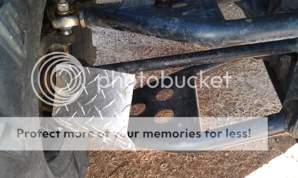

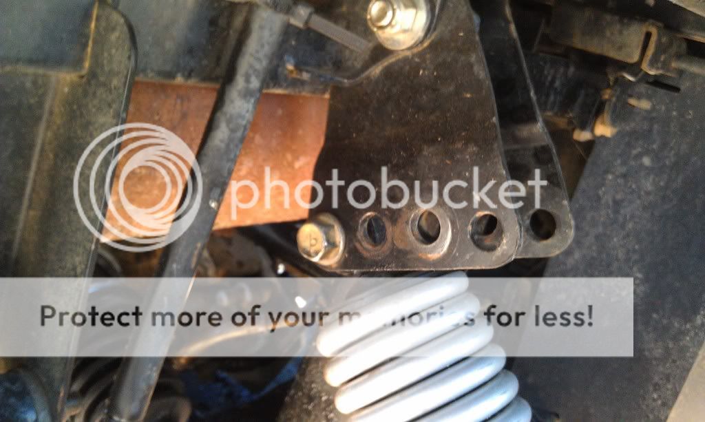

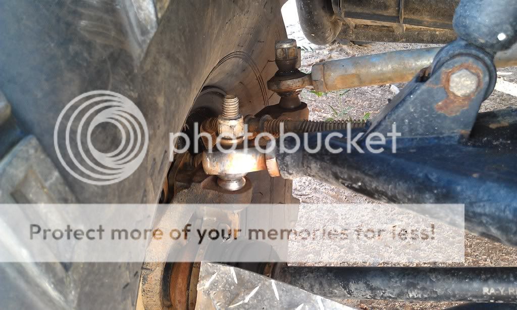

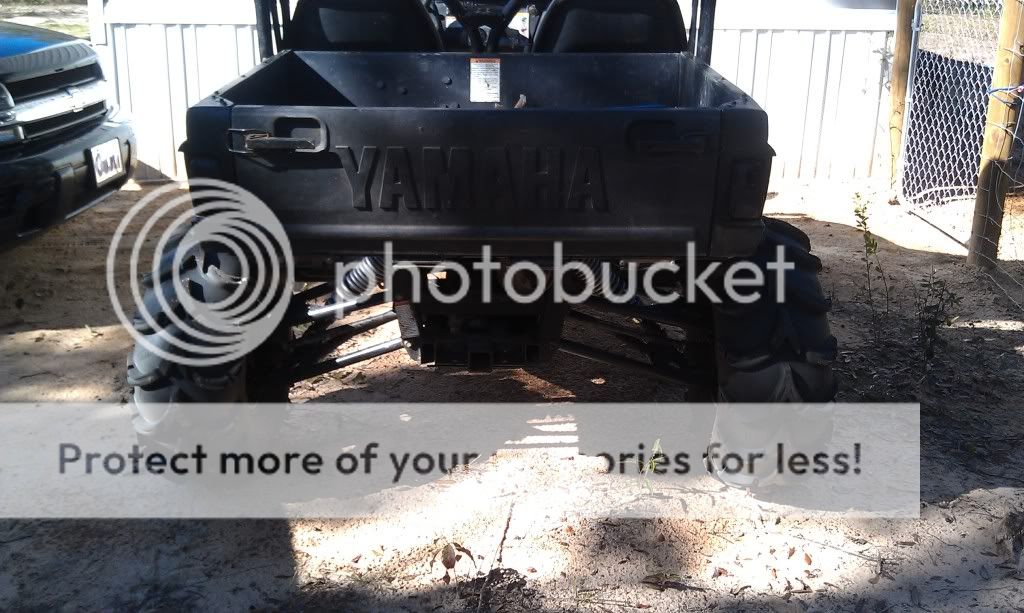

I bought this 2004 rhino 660 with this lift and tires on it. The shocks look stock just turned up. I know the A arms are aftermarket and the tie rods also has gorilla axles. Over half of the tires stick out on front and rear. Would like to know if someone could give me a little more info on it also on the rear the top shock mount has 4 different holes to bolt it. What is this for and where is the best place to put it? It seams the rear suspension is a little soft.

not sure what kit that is, it appears to be a mid travel kit with that width.
the different mounting holes will stiffen up that rear. move it out to that third hole, where you can see it has already worn. that will stand your shock up more, adding a little more lift and stiffening up the ride.
overall though that is a great looking rhino, i love the stance it has

That's what I thought the holes were for but I figured I would ask. It rides really good i can hit bumps doing like 40 and its smooth. After I stiffen up the rear it may get even better cuz it feels like it bottoms out some times hitting large holes.

Discussion Starter · #9 ·
yea that looks like it. I guess some one just put gorilla axles in it. Is there any way to tell if there really gorilla axles? I mean they got the stickers on them but I need to replace some of the boots so need to know if there real gorilla axles. I saw some number engraved on the but dont remember what they were. Just asking but with all this work done to the rhino what do you think its worth? o and also they said it just had a motor put in at a yamaha dealer and when they did that they put a digital dash "for warranty purposes" says it has like 125 miles and like 25 hours
