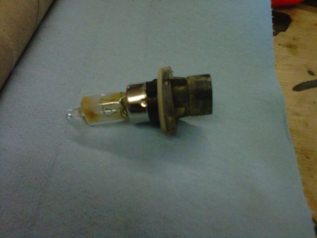

can some one tell me what bulb type this is?

054703. 2v3030. Trident these are the only markings on the bulb its self. does yours have any of the same?

Does that mean youa re doing a conversion? That does not look like HID.. looks like dual element stock bulb

yes i am doing a conversion that is a stock bulb im trying to find out what it is. and i want to see if people use just a single HID bulb kit or one with the Hi/Low option.

it is the same bulb as mine. just completed hid conversion on mine. used the ebay xentec hid kit for like 39.00. works great so far. figured it was cheap enough that if it did go out i could buy several of em before it was as much as some of the high end ones =] it is a single beam system so after doing some research found that other users were using yellow wire for power. i spliced black to black for ground. dead ended the green wire (low beams) and spliced red to yellow (high beam) for hot wire. i cut about 2 inches from the end on my stock pigtail and connected there that way i can still disconnect and remove lights or hood as with stock setup. hope this helps.
