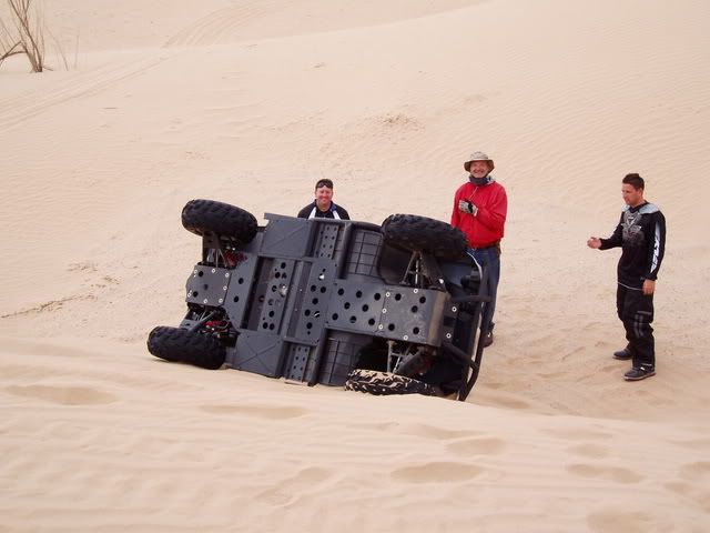

New to the forum. Just picked up my Rhino a couple of weeks ago and love it. I went to the Rhino Crash in Glamis and the following weekend to the dunes near Yuma. I had a blast and lost my virginity, I rolled it! I'll post some pics as soon as my friend sends them to me.
You need to get some offset wheels or wheel spacers .... since you have those nice wheels I would just get some wheel spacers ..... you will need 1.75" or 2" on all 4 corners ...... you can get them on ebay for arounbd $ 150.00 for all four ...... It will add tons of stability to the Rhino .... you will be happy and you wont roll so easily .....
